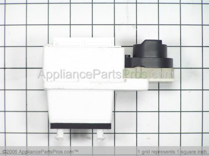

    You can stick something small in the vent to see if the vent louvers open, like a small pocket screwdriver or small pen/pencil and see if more cold air comes through and if so, then leave it in till your new air diffuser arrives.
    I've replaced lots of these for this issue.
    Here's the one for your model you can order:
    Whirlpool WP2216112 Air Diffuser - AppliancePartsPros.com
