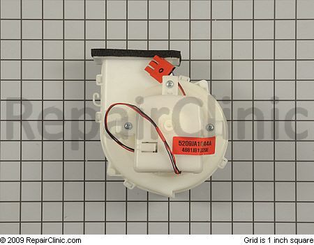

    I have a Kenmore Trio that is showing Er IF on the display. I found the icemaker caked in ice, the cubes backed up and the water kept cycling and basically encased the entire mechanism. It backs up or gets cubes stuck often, so I replaced the ice maker. Error still shows. A little more research determined ice maker fan, so I found the fan, pulled the cover and the fan motor was also caked with ice. I removed the ice, repowered and the fan will cycle on about 5 seconds and off for about 15 seconds three times and the error code shows up again and fan goes dead. The freezer fan is working fine, so we haven't lost anything in the freezer, just the ice maker/water dispenser.
    I had the mother board replaced a year or more ago, I can't remember the error code when that happened, but this code seems familiar - just can't be sure.
    I cannot find the ice maker fan online anywhere, but since it cycles fine and does not get hot, I assume it is ok. During the on cycle, it seems strong and steady.
    SO - am I looking at another mother board?? I could easily assume that the ice build up may have stopped the fan and took out the board.

    Here's is the ice maker fan motor assembly:
    Cooling Fan 5209JA1044A Order now for same day shipping. 365 day return policy. RepairClinic.com

    That is the fan! Cool. Thanks, Jake, I'll change each one first and update what happens for future reference.

    So, UPDATE! Ordered a new ice maker fan and mother board to swap each and see which fixes the issue. Installed ice maker fan first, all has been well for a full day, ice maker is making ice, error code is gone.
    So there it is - Ice Maker Fan!!
