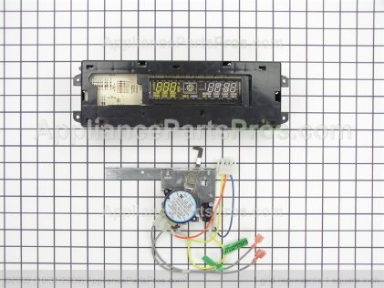

    I have a Wall unit convection oven GE profile JTP18W0A2WW. It will suddenly turn itself off in the middle of baking. When this happens the display goes blank. If you push a button on the control panel the clock will start blinking and display a time. It will blink, however the clock will be slow in relation to when the oven shut down. Also, the oven will restart if you prompt it to, but the temp will be higher than programmed to operate. I have not noticed these symptoms occur unless the temp is set over 400 degrees. No error codes. Any ideas?
    82,120
    It sounds like your clock/oven control board is bad.
    Here's the clock/oven control board for your model you can order here:
    GE WB27T10219 Electronic Oven Control/clock Kit - AppliancePartsPros.com

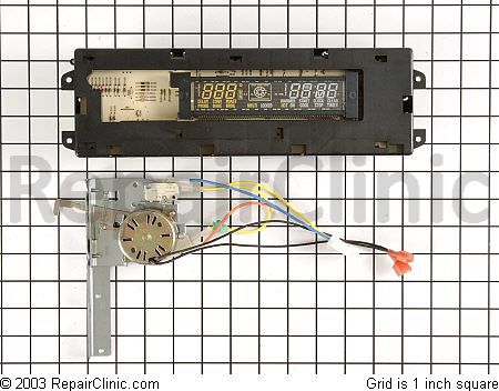

    Thank You. How difficult is it to R&R? Does it come with instructions?
    82,120
    Yes, it should come with instructions. Just turn the breaker off to your oven first.
    There should be a few screws under the front control panel to access it.
    Its #16 here:
