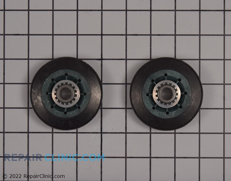

Dryer making rumblung noise kinda sounds like a steam locomotive. I did notice the drum has some play to it. Noise probably caused from wobbling. What do I need to fix this issue?

Chunk missing from the drum belt.
Drum rollers wheels.
Something caught in the fan blower wheel ( chunk of lint, dryer sheet ).
Would have to be investigated.

Parts came in today. Do I work from the lower front or back?
Actually got it. Top had to come up and front off. Remove belt from pulling and take out drum. Replace everything and put back. Real quiet now 🙂
