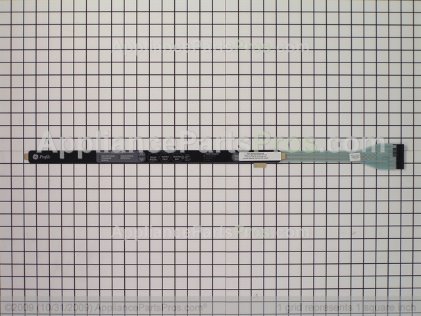

    I have a fairly new GE Profile dishwasher. Everything seems to work fine except I am unable to change the cycle selection on the touch pad. Every once in a while the cycles will just start rotating and then Im stuck with whatever cycle has been selected until it happens again. This behavior seems to manifest itself directly after the dishwasher finishes a cycle, but Ive only seen it occur a few times, so I cant be sure. Im guessing it might have to do with moisture generated when drying. Perhaps I have a bad touch pad...but everything else seems to work. Unfortunately, I live in a rural area and the closest GE technician is several hours from my home. Im hoping someone can help me diagnose and fix this problem.

    Yes, it sounds like the keypad assembly is bad.
    Have you tried to turn the breaker off to your dishwasher for 5 minutes and see if it resets?
    Here's the keypad assembly for your model you can order here:
    GE WD34X11210 Keypad - AppliancePartsPros.com
    We have a special program here, all parts you order from our links we post are returnable within 365 days for a FULL refund if they don't fix the problem.

    Jake thanks for your response and the info. Yes, turning off the breaker resets the cycle.

    Its #719 here: Parts for GE PDW9280N20SS: Escutcheon & Door Assembly Parts - AppliancePartsPros.com
    Looks like it just prys up from the left side.
