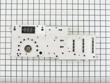

    Here's the control board for your model you can order here:
    GE WH12X10355 Control Board Assembly

    This is a follow up to my first post. I unplugged the washer from AC power for 24hrs. I plugged it back in and the Door Lock Indication went away. I used the washer to do maybe 4 washes to catch up on much needed clothes for my family.
    I noticed after the fourth wash, the washer stopped at the 01 minute left on the cycle with the Start/Pause button blinking. This is the same condition I seen before. I pressed the start button and the washer did change to 00 minutes. The washer would not run after this.
    I then replaced the Control Board. The Door Lock Indication remained active even after changing the Control Board. I then placed a order to the door lock assy. I unplugged the washer for 24hrs while waiting for the lock assy to arrive. The washer worked again for a few washes and stop at 01 minute left on the cycle. Let's see when the lock assy comes to see if that fixes the problem.

    Ok, then the new door lock assembly should fix it.
    You can return the control board for a full refund.
