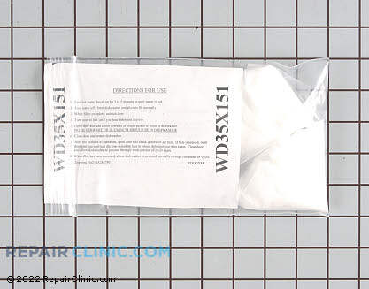

    For the white film issue:
    When I lived in Tucson, Arizona this was a major problem, I would always recommend my customers to buy this product:
    Cleaner WD35X151 Order now for same day shipping. 365 day return policy. RepairClinic.com
