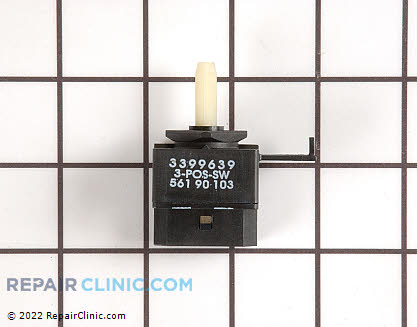

    It is me once again. Thank you for the advice. Before I call a Sears Tech, I would like to run another scenario by you. I have been running med-large heavier cotton loads on the dryers HIGH Cotton setting. I decided to try the same size loads on the Med-Perm-Press setting. I have run 5 of the same size loads thus far. Every one dried perfectly. Does this make any sense? When I use the High Heat setting, it works sporadically. When I use the Medium Heat setting, it works flawlessly. Same size and type loads. Can you think of any reason why this would happen? As long as it continues to work well, I am fine with using the Medium setting. But if this is a sign of a problem, I would like to repair it. Thank you again!
    92,207
    Ok, then its either your temperature selector switch or cycling thermostat. I'd order both to be on the safe side.
    Here's the temperature switch for your model:
    Manufacturer part number 3399639 is RepairClinic item number 527732
    Here's the cycling thermostat for your model:
    Manufacturer part number 3387134 is RepairClinic item number 2893
