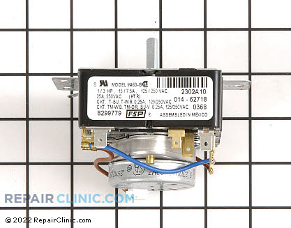

    Here's the timer for your model you can order here if needed:
    Timer 8299779 Order now for same day shipping. 365 day return policy.
