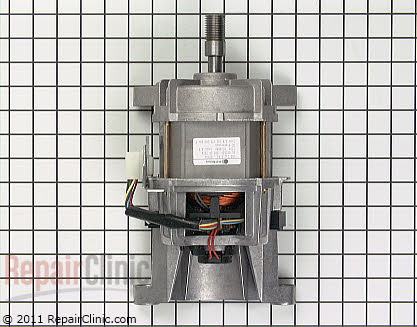

    Yes, it would be the motor then if the tub pulley spins by hand and you don't notice the noise in the tub bearing.
    Here's the motor for your model you can order here:
    Drive Motor 131276200 Order now for same day shipping. 365 day return policy. RepairClinic.com
