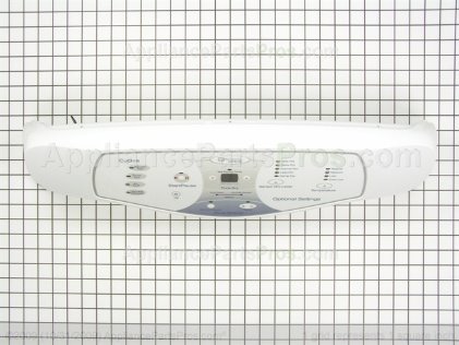

    Yes, sounds like your control panel keypad assembly has shorted out.
    Here's the repair manual for your model: http://www.applianceblog.com/manuals/16023110.pdf
    You can order it here:
    Whirlpool 33002896 Console/membrane Wht - AppliancePartsPros.com
