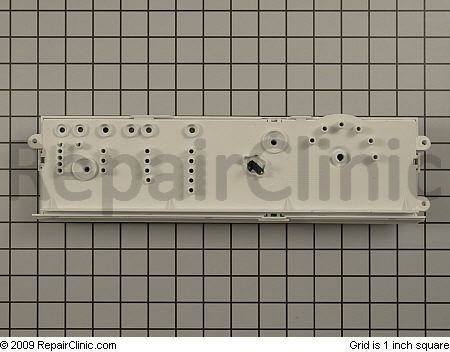

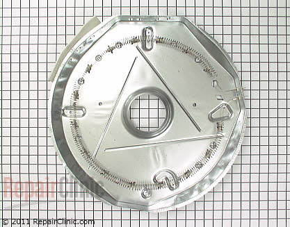

    My Kenmore dryer has recently started acting funny. It will run, but will stop after a few minutes and the 4 lights on the right side will blink. In addition, there is no heat. I have unplugged the unit for a few minutes and plugged it back in, but no luck.
    I have read on a previous post that it might be the Thermistor but when I posted on the managemylife.com website that Sears has, they told me it could be the entire control panel. Is there any way to see which one it is?
    What are your thoughts on this?
    Michelle

    Hi Michelle,
    Could be 3 issues, control board, thermistor or heating element.
    Had another member back in May with this exact same issue and they found the heating element broken. So check the heating element first.
    Here's the heating element for your model you can order here if needed:
    Heating Element Assembly 131553900 Order now for same day shipping. 365 day return policy. RepairClinic.com
    Watch this video to ohm test it for continuity:

    If the heating element is fine, then ohm that thermistor should be 50,000 ohms at room temperature. If it is then its the control board thats bad.
    The thermistor sits on the front of the blower wheel housing.

    Here's the control board for your model you can order here if needed:
    Main Control Board 137008010 Order now for same day shipping. 365 day return policy. RepairClinic.com
