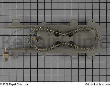

    Howdy- Found your forum w/Google search. My dryer blew the thermal fuse. Ran the diagnostic routine, no errors. Since my electrical service panel is within arm's reach of the dryer, decided to jumper across the thermal fuse and see what was happening. Turned the dryer on a manual cycle with temp control set to "Air Only", and the heater coil is coming on full-blast, so obviously the heater isn't being regulated. Is there anything this could be besides a control board issue? Thanks much.
    John
    82,138
    Hi John,
    It sounds like to me your heating element is grounded causing it to come on in air-only, when it shouldn't be.
    Its likely the heating wire may have broken and is now touching the heater housing.
    You would need to take off the lower front access panel under your door, then take off the duct assembly#45, by removing the two #11 screws: Bulkhead parts for Whirlpool WED9200SQ1
    Then the heating element is #14 and the heater housing is #49. You have to remove #41 the shield first.
    Unplug your dryer first before taking it out to check it.
    There is a video now to show you how to access/replace the heating element on this model. Just click the part link below and the video is there.
    Whirlpool 8544771 Heating Element

    Hi Jake, thanks for the reply.
    Before taking the heater out, I decided to check resistance from the coil to ground, got about 40K ohms (without unhooking any wires). Would this be enough continuity to allow the coil to pass current? Thanks.
    82,138
    Yes, so thats the issue.
