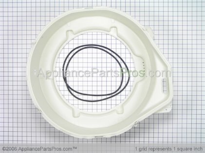

    Its definitely the tub bearing thats bad and is causing those plastic shavings.
    Oct 2011
    NJ
    21
    Thanks Jake. I cleaned off all the shavings and ran it last night and all it did is create more shavings. I'll go with your diagnosis as I know the pulley at the back isn't broken and the absorbers look ok (plus - that wouldn't account for the inner tub not spinning in a circle). I'm trying to schedule a repair now. It's a catch 22 because all of the repair shops charge a minimum service call fee ($100-$130 it seems). So as long as the parts are covered (and it doesn't take too long) it's worth it to repair it. Too bad you and Jeff aren't closer to me!
    82,071
    Did you contact Whirlpool directly to schedule a service call?
    The 2 parts you will need would be about $500 and Whirlpool will pay that.
    Tub front:
    Whirlpool 285981 Outer Tub - AppliancePartsPros.com
    Rear outer tub assembly:
    Whirlpool W10253866 Outer Tub - AppliancePartsPros.com
