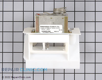

    Hi, I think my damper is the problem on my frig. Frig side is warm. Freezer side is at 0 degrees.No air is going into the frig side. Can the damper control be tested before i spend $100 on a new one. Could it be that the cold air is backing up in the freezer side and freezing my ice cube water line? I had frost in back of freezer.Thanks.
    87,081
    Do you hear the fan in the freezer blowing air?
    If so, then you'd need to actually get at the air damper and check it for an ice clog or the damper door being stuck closed.
    You have to remove the light shield #421 and the damper is #426 here:
    http://c.searspartsdirect.com/lis_pn...9192-00007.png
    Here's the air damper for your model:
    Manufacturer Number WR09X10002

    We took apart the damper control and we could see that it moved when the coil was put in ice.So I decided to unplug it and let it sit overnight. This morning, there was water on the floor, I assume from ice melting. Plugged back in and the fridge side is now cool and cold air is blowing through the damper.Maybe ice plugged the air flow to the fridge?Ice maker is making ice.The freezer fan is running.So why did the back of freezer frost up? I'm thinking defrost timer or the defrost element itself. We are going to remove the cover inside the freezer side and check both.How should that be done? Once again, thats for all the help. Bill
