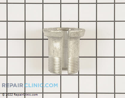

    I had a loud squeal during the spin cycle. I removed the inner basket and removed the drive block. the tube was loaded with nasty smelling stuff.
    The inside tube of the spin basket seems pretty clean.
    I put the washer into the spin cycle without the basket on and it does not squeal anymore.
    Could the drive block have cause the squealing noise? I don't want to replace the drive block if that will not correct the problem.

    Here's the tub drive block for your model:
    Drive Block or Bell WP389140 Order now for same day shipping. 365 day return policy. RepairClinic.com
    This video shows how to check and replace the drive block:
    You can see the comparsion here:
    See the one on the left, its the old one, the one on the right is the new one. It has to have those 2 ear slots. Does yours look like the one on the left or right?

    It has the cut outs. Like I mentioned, it does spin, it was just squealing very loud at the begingingof the spin cycle. Now with the tub out, there is no squeal.
    Here are two pictures that might help show the condition.

    I need to see a picture of the top of it.
    It looks pretty worn out anyways, I'd change it if I was you.
    The squealing can also come from the clutch with a load on it.
    Description of the symptoms I would check:
    Clutch (try to spin the clutch band inside the clutch drum . It should be very hard to spin by hand)
    Clutch Assembly (part #2670) from RepairClinic.com
    drive block (make sure the 2 slots that engage the "EARS" in the basket drive are not worn out
    Drive Block (part #2858) from RepairClinic.com
    Basket drive (check to make sure the 2 "EARS" at the top that engage the drive block are intact
    Basket Drive (part #1254) from RepairClinic.com

    Thanks for the great info! When I took the clutch out, the retainer spring that holds the brake cam driver actually fell off and was wedged under one of the shoes on the clutch!
    I put everything together, but I have a bigger problem. The shaft where the spring clip attaches to is worn down somehow to where there is basically no groove left to put the spring on to hold the plastic cam driver.
    Am I going to have to replace the drive tube now?

    Yes Jim, no other choice but to replace it.
