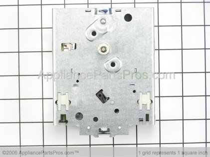

    Here's the timer for your model you can order:
    Whirlpool WP3953248 Timer
