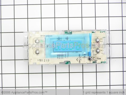

    The clock oven control board sends 120 volts to that oven igniter, so that would be the bad part.
    Here's the clock oven control board for your model you can order:
    GE WB27T10469 Oven Control Board
