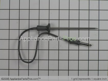

    Do you have the meat probe in or is it out?
    You will want to check the resistance of the meat probe at the control board. When testing you want the meat probe plugged in and sitting in boiling hot water (temp 210 degrees). The resistance should be between 3800 and 4000 ohms. If not then the meat probe is bad and would need to be replaced.
    There should be a connection the the control board that says meat probe on the control board. That's where you ohm test it at.
    Here's the meat probe for your model:
    GE WB20X5050 Meat Probe - AppliancePartsPros.com

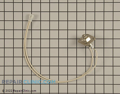

    If your meat probe ohms out fine, then its likely a problem in the meat probe receptacle.
    Receptacle WB18K10006 Order now for same day shipping. 365 day return policy. RepairClinic.com
