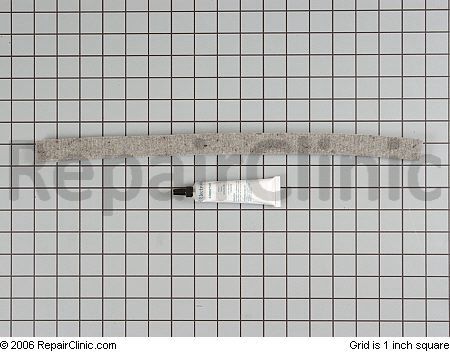

    Here's the front glide felt pad kit for your model:
    Felt Seal 5303937182 Order now for same day shipping. 365 day return policy.
