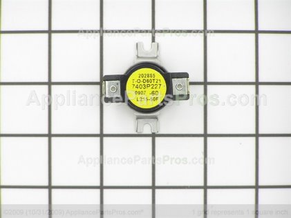

The oven stopped working on Bake setting, but broil and all four stove-top burners work. No heat at all on bake at any temperature. What could this be?
I'd first disconnect power to your range, then ohm test the bake element. You'd pull the range out from the wall, then remove the back access panel then you will see the bake element terminals towards the bottom.
Here's the bake element for your model:
Bake Element WPY04000041
Ok, ohm test the hi-limit thermostat for continuity, its located in the back of the oven, once you pull the range out from the wall, remove the back access panel and you should see it. Make sure the range is unplugged first.
What this video to ohm test it:
Here it is for your model, but Its No Longer Available:
7403P277-60 Thermostat
If it ohms tests good, then the problem is the clock oven control board, and that's No Longer Available Either.
