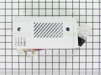

    I also noticed #429 is the complete damper door thermistor assembly, and the part number has changed to this one below:
    GE WR13X10988 Damper Cover Asm - AppliancePartsPros.com

    I'm afraid we are at a dead end, since the damper part number changed and it now comes with a new thermistor, then they may have upgraded this damper part, and I know you didn't order the complete damper assembly I posted above.
    That's about the only thing it could be at this point.
    Nov 2016
    Woodstock, Ga
    So if I order that damper all should be fixed. Im assuming its possible for my damper to open and close(bc it is) but still be bad? But would that change my digital temp display? It's reading way off. Or is that a separate issue
