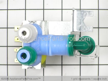

This has happened twice now. A few weeks back there was a sheet of ice in the bottom and the ice tray itself had a half inch of water in it with all the ice cubes frozen to it.
The first time this happened I pulled everything out and found that the small cup on the ice maker was plugged. It's the cup that receives the water from the hose coming into the freezer.
I just removed the ice maker, cleared the cup, re-installed it and everything was fine. Here we are two weeks later and there is another sheet of ice in the bottom of the freezer and no new ice cubes in the tray. This tells me the cup is plugged again.
Anyone ever heard of this happening? My guess is the feed hose is leaking slowly and ice is building up.
What say y'all?

THOUGHTS UPDATE:
Haven't had time time to get in there just yet but my theory is that the "Dual Inlet Water Valve" is leaking and causing the ice to build up on the inlet to the icemaker.
137,682
Hi qman, good to see you again!
Yes, you are correct, the water inlet valve is causing this.
WP67005154 Water Inlet Valve

Will do Jake.
I was so sure of myself that I pre-emptively ordered the part. Thanks pal.
137,682
Sounds good qman.(y)
qman
Jan 2, 2007
160
CO
Replaced it and now the ice maker doesn't produce ice at all.
Whatcha think Jake?
137,682
Make sure your ice maker fill tube is not clogged with ice, thus not allowing the water to fill the ice maker tray.

I did check from inside the freezer but I will check again.
137,682
Pull the fill tube out from the back and then you can see if its clogged much better, then from the front.
