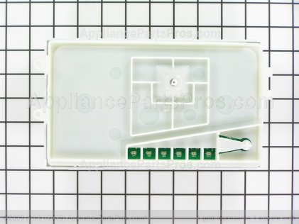

    Here's the shift actuator for your model you can order here:
    Shift Actuator WPW10006355
    Access/replacement Video included in the part link.

    It says in step 17 your shift actuator is good, then order the control board, that's the only other part it could be.
    Here's the control board for your grandmother's model:
    W10581897 Electronic Control Board

    Forgot to update the thread. Even after all of the tests had passed, changing the shift actuator did actually fix the problem, the control board was not necessary. Thank you for all of your help.
