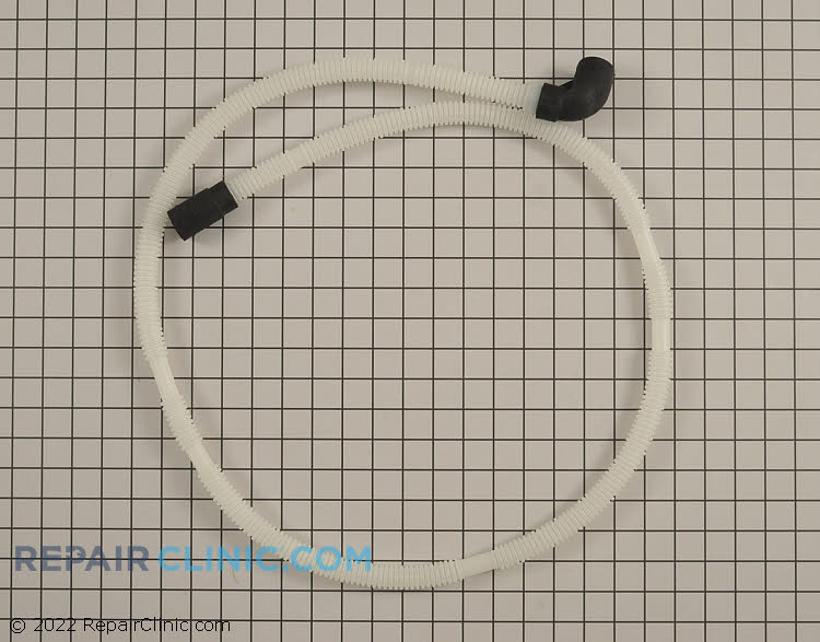

For the intermittent draining problem--->on this model there is a backflow check valve in the elbow of the drain hose, if that is clogged it will drain intermittently or never drain properly period.
Here's our main thread on it:
That thread shows the black elbow which has the backflow check valve in it. Check it for clogs.
Kathryn and Tom found it clogged up, post #26 and post #27 and post #29.
Here's that drain hose with the elbow in it that contains the backflow check valve:
WPW10545278 Drain Hose

Ok so I pulled the hose out and only found the smallest bit of hair clogged in the flap at the elbow and the flap does seem to move better. Could that little bit really make a difference? (See photo).
125,745
Possibly, have you tried the draining cycle again?
What I do is take the drain hose off the garbage disposal or sinking plumbing where the water exits, then get a bucket to catch water in, and put the drain hose in the bucket and start a drain cycle and see how fast the water comes out into the bucket. You should have a lot of water pressure force coming into the bucket.

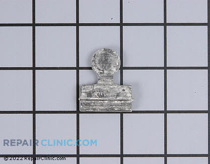

Drain Pump WPW10348269
I'd first check your voltage with a multimeter at the drain pump electrical terminal wires, it should be 120 volts at the drain pump when its in the drain cycle. If you get 120 volts and the drain pump isn't running, then its bad.
When you click the part link to the drain pump you will see a video of how to access it.
For the black rubber check valve flapper:
Check Valve WP8268375
There is a link to the video to show you how it goes in properly.
