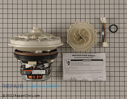

I did eventually get the screw out. Would a damaged impeller be visible to the (layman's) naked eye? It didn't seem broken in any obvious way to me, other than the scars incurred when I jammed it with a screwdriver to get the screw out.
I removed the debris (including that cellophane wrapper -- yikes!) and flushed everything out with vinegar, but unfortunately the saucer-shaped unit with the screen on it does not seem to come apart. After reassembly, there's no change in functionality.
Is it normal that there's a lot of water draining immediately after the unit is turned on -- it seems to me it should fill first. Is it possible there's a stuck valve somewhere? I didn't come across anything that looked like an outlet valve, did I just not go deep enough?
If the impeller looks ok. But the pump/motor assembly can still be bad.
