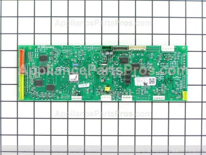

I replaced the oven control board on my Kenmore Pro Dual Fuel Range, Model 790.79523. The control board needs to be programmed after installation and I am looking for the instructions for how to program it. I have done this once before, but cannot find the instructions anymore. Thanks for your help!
Here's the oven control board for your model:
316460212
I'm attaching your tech. data sheet below, look on Page 11 POTENTIOMETER CALIBRATION
  • 318204800.pdf
