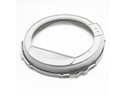

I tried searching but couldn't find anything helpful. I appreciate any help anyone can provide!!
I took off the back panel and ran the e. It started leaking from here:
Looks like its leaking from the tub cover and running down the side? Or its leaking from the outer tub itself, and that can't be replaced.
Here's the tub cover for your model:
ACQ85605501 Cover Assembly,tub
We have the same model and it's leaking during the wash cycle for sure, but I don't see any leaking during other cycles. The water is visible near the front left, but does travel a bit across our floor to the right front. Which part or parts should I try switching out? Thank you.
