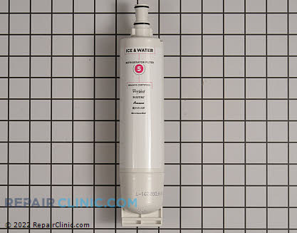

    Have you changed your water filter in your refrigerator lately? If the filter starts clogging, it will decrease the water pressure and cause this.
    Here is the water filter for your model:
    Water Filter EDR5RXD1 Order now for same day shipping. 365 day return policy. RepairClinic.com

    I did recently change my water filter, maybe a month ago, do you think I may have a bad filter?
    Thanks.
    82,224
    No, you shouldn't have a bad filter.
    Did you run 10 glasses of water through your water dispenser after you changed it, to get the air out of the lines?

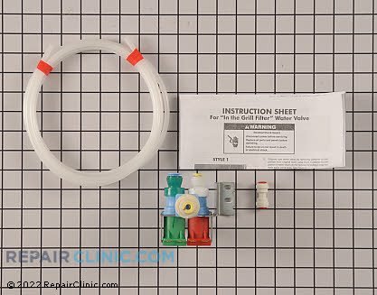

    The only other thing I can think of would be your water inlet valve is malfunctioning.
    Here is the water inlet valve for your model:
    Water Inlet Valve W10408179 Order now for same day shipping. 365 day return policy. RepairClinic.com

    Is the water going to your refrigerator at decent pressure? The valve requires a minimum of 20 Lbs of water pressure to properly seat. If less than that is available, the valve might not seat and a small leak will start. The drips will freeze in the fill tube causing the problem you found.
    In that is not the case then... well, this is going to sound kind of goofy but get some aluminum foil and make a column coming off the top of the fill cup of the icemaker up to the top of the freezer around the fill tube, leave an air gap around the tube. This will keep the cold air from blowing directly on the tube and freezing it. Sounds goofy but it does work in most products. I think a replacement fill tube is available if this continues to be a problem.

    Thanks for all the advice. I replaced the valve and everything seems to be back to normal.
