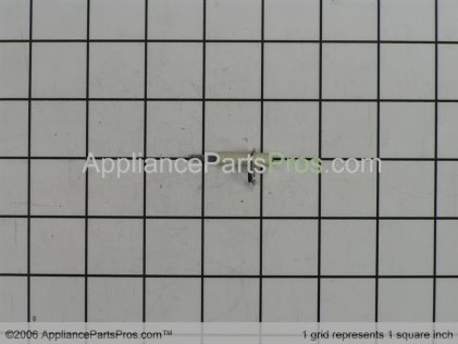

For the top surface burner not igniting, that's usually a bad ignitor. Does it still click when you start it, but there is no spark coming from it?
Here's the top surface burner ignitor for your model:
WPY0316773 Top Burner Igniter
Video included in part link.
