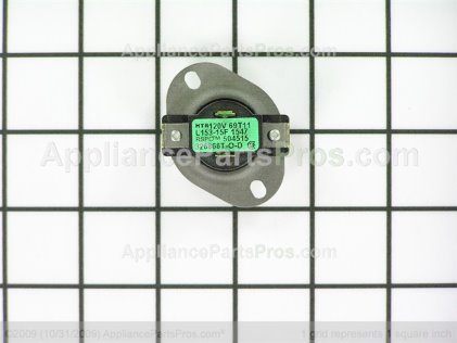

Mayb I can voltage check out what’s going on... I’m certainly not an electrician, but it seems like power to drive the heating element comes into the green cycling thermostat located in the fan exhaust housing on a black wire. It (power) exits the green cycling thermostat on an orange wire and goes to the thermal fuse. Power exits the thermal fuse via a 2nd orange wire that attaches to the red limit thermostat. There are 2 wires exiting the red limit thermostat, a thin blue and thick black. The thick black goes to the lower terminal of the heating element. The think blue runs to the front of the drying ... I am not sure I can see where it terminates.
So I’m assuming I can check the voltage coming into the green cycling thermostat and existing the heating element (upper terminal, black). I’m guessing when heating it’s drawing 240v. So if the element stops heating when voltage is present, then I’d guess the heating element is bad. I guess...
Any other ideas?
139,461
I don't have the wiring diagram, but if the heating element is coming on when you first start the dryer then shuts off per the cycling thermostat and never comes back on, and the cycling thermostat is NOT CLOSED as the temperature drops below its temperature rating, then its a bad cycling thermostat.
You'd need a multimeter to ohm test the cycling thermostat, with power disconnected to the dryer, it should read 0-1 ohm, which means its CLOSED.
The cycling thermostat is located on your blower wheel housing.
Here it is for your model:
D504515 Thermostat Grn

Please don’t take this the wrong way, but per my original post I initially replaced all 3 thermostats and the problem has persisted. I can test the brand new thermostat but I’d be shocked to fine the original went bad and then the replacement was also bad....

The old cycling thermostat reads 0 ohms. The new one installed, power cord unplugged, reads zero ohms. I’m taking the measurements at the outer edges of the thermostat across the large silver terminals (black wire, orange wire). There are 2 smaller brass terminals coming out of the thermostat, which I haven’t measured.
