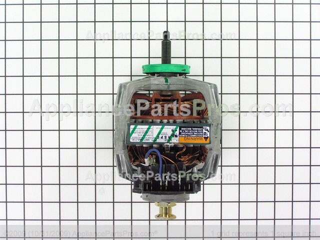

Also could the other leg of the 240v be from the motor side?
Yes, see L2 on your wiring diagram goes to terminal #1 on your motor, then it contacts terminal #2 that goes to the heating element.
So if your not getting 120 volts at #2 on the motor and the wire from the motor to the heater is not broken, then the motor is the culprit.
Here's the motor for your model:
Assy Motor & Pulley-120/60 Pkg D511629P
