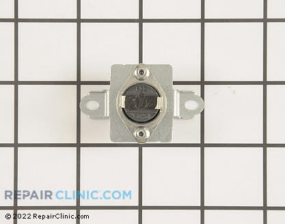

You possibly blow out the thermal fuse too, its located on your heating element housing, that's possibly why its still not heating.
Here's the thermal fuse for your model:
Thermal Fuse WP35001193
There is a video in the part link that shows you how to ohm test that thermal fuse. Unplug your dryer first!
The reason is takes a long time to dry a load and these parts went out is you have a vent restriction to the outside of your house. Go outside your house and see if your dryer vent is clogged with lint.
Also pull the dryer away from the wall and see if its clogged with lint in that your exhaust where it goes to your wall.
