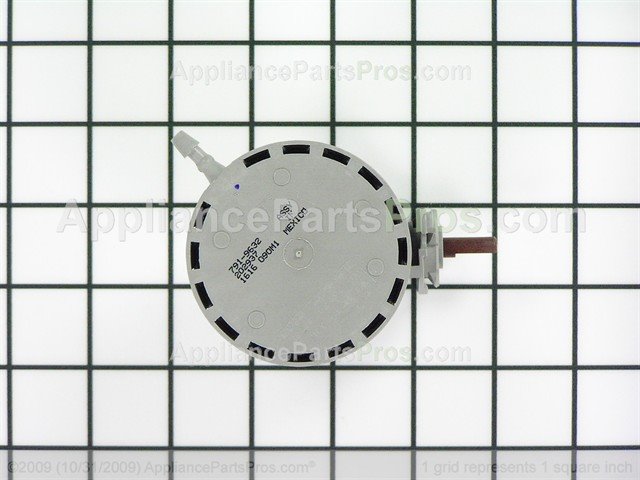

Model AWN432SP113TW04 just keeps on running with no water. Pull knob and it goes from one cycle to next cycle to next cycle...round and round. AND, no water runs in the tub.
I'm thinking timer. What do you think or what diagnosis path do you suggest. Plenty of water going to the washer.

Ok, did you blow through the water level pressure switch hose that goes down to the tub?
The water level pressure switch controls the water fill and could be stuck closed, meaning it will agitate WITHOUT water.
Also remove the water level pressure switch hose from the NIPPLE of the pressure switch and blow into that NIPPLE and listen for a click sound.
Here's the water level pressure switch for your model:
Switch,pressure
Jake, thank you for your help. I've been sick this week and here is my update. I replaced the timer with a new Alliance timer. That had no effect
on anything. Just out of pocket $82. I started the new timer on Permanent Press and it went through that cycle and and kept on going around without
any water added but it won't stop at the end of a cycle. I'm gonna try and blow through the pressure switch and let you know what happens.
I checked the Washing Machine Valve 202395P with an ohm meter. I had it set on 2K and I got 1.335 and 1.352.
Start the washer on a new cycle on COLD ONLY, then when it should be filling check for 120 volts at the COLD SIDE water inlet valve electrical connector, meaning remove the electrical connector to the COLD SIDE water inlet valve and put your meter probes in that electrical connector and see if you get 120 volts.
WOW! I got water now. I think when I blew in the pressure switch it didn't click at first. Maybe it was stuck. I'm going through a cycle now.
Now, if it will just stop and the end of this cycle. Since it is filling, I don't guess I need to do what you just posted?
It is working like a charm. I put the old timer back on. Would you replace that pressure switch or just right it up as being
stuck as freak issue and move on?

Yes I would order and replace that water level pressure switch, because if it stuck once It will stick again.
Thank you Jake! It is amazing that switch affected the timer.
