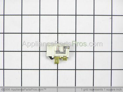

Here's the compressor start relay for your model:
WP10097202 Relay, Start
If no rattle, What I do is ohm test the 2 parallel holes on it. I Unplug the refrigerator first then remove it from the side of the compressor. Then take the wires off of it and ohm the 2 parallel holes where it pushes on to the 2 parallel compressor pins.
Normal would be 0-1 ohms reading on the multimeter.

I have now uninstalled the brown box relay. No rattle, but it smells like burnt toast. I'll give the multimeter a try on it.
I also uninstalled the white thingy Overload? that was above it on the third prong on the compressor.
When I opened it I broke the plastic slightly.
Might you know the product number for the BRF20TW for this item?

I have the multimeter.
The brown relay box tested at 4 ohm.
The white overload also hit a minimum of 4 ohm, though the reading jumped around a fair amount.
Does this mean that it is the relay that is broken?
If so, then buying this part should fix my problem!
