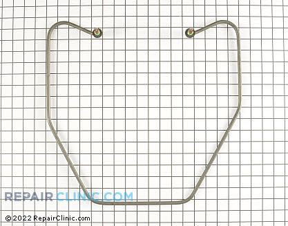

I have Kitchenaid model KUDI01ILBT6 with the clean light blinking 7 times. I removed the dishwasher unit and checked the ohms of the heating element and the drain pump. Both of these had continuity. I also checked continuity in the fuse in the front panel, that was fine too. I checked the chopper screen and check valve. Their was gunk, but nothing that would have prevented them from working properly. Cleaned them out.
Then I read further in the thread that the heating element needs to measure at least 11 ohms? But in the video tutorial for removing and checking this piece it state anything between 0-50 and the part was ok. Which is correct? Mine got a reading of 1.
If my heating element is ok, then I wondering if I need to replace the whole front touchpad and control panel or if I can just replace one or the other. If I only need to replace one of them, which one do I replace?
Is there any other part I should check? I know it could also be blinking if the water isn't circulating properly and my dishwasher has seemed to have gotten louder over the past few years.
121,870
Well, watch the video again, they show the element as being good with the digital meter at 9 ohms, normal is about 11 ohms. So 9 ohms is fine, then they test a dead element and the meter didn't move it stayed at 1 in the video.
So if your meter didn't move and stayed at 1, then its bad.
Here's the heating element for your model you can order:
Heating Element WPW10082892
