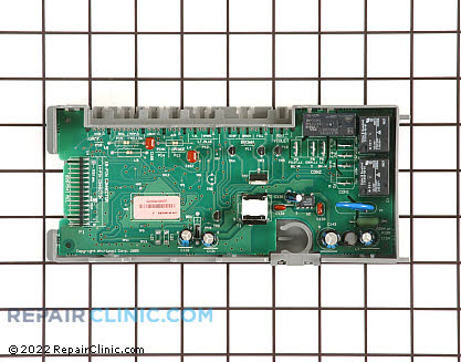

What the problem is if the element checks good is your control board.
Here's the control board for your model you can order here:
Main Control Board 8564543

Excellent, good job, glad to hear the new control board fixed it.:)

I had one do this before and periodically do the clean light blinking 7 times fault, but it wouldn't do it every time and even though the heating element was heating fine, the heating had a white coating on calcium build-up on it, so I replaced the heating element and problem solved.
Does your heating element have a white coating on it? If not, then your heating element should be fine, so I'd replace the control board on yours.
Here's the control board for your model you can order:
Main Control Board WPW10084141

hi. i had the 7X clean blink problem also. heating element is clean and heats well, so i didn't check it electrically. i replaced the control board. after replacement, the unit ran as designed for a few cycles...then the 7X clean blink started again. at this time i noticed that the "normal" cycle light would not light when pressed, so i only used the "heavy duty" cycle. i've been in the "run-unit-reset-every-time" mode for several months now...i just got used to it. this morning, that "fix" no longer works. now, the "light china" cycle and the "cancel" lights blink continuously. the old reset pattern doesn't work, nor do those specific lights light up when pressed. i doubt the control board is bad, and the heater always heats (when it's actually operating). any additional options to try? maybe the control button panel is defective? just guessing here... thanks for any help!

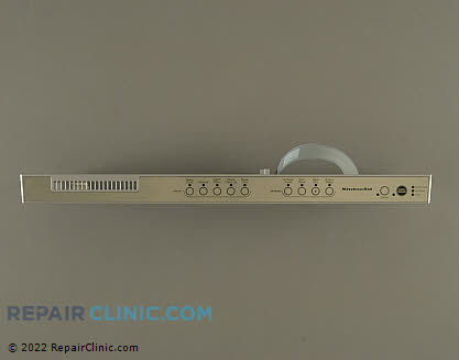

That indicates the control panel is bad.
You only posted a partial model number, we need the full model number, open the door and you should see the model number tag.

update from this morning: i randomly pressed the buttons in different orders to see if anything would change. see attached photos. notice the very slight green light for "normal" cycle. remember, the control board is new (purchased from here). 12604937_1250822121610869_7062067514607370333_o.jpg12628476_1250822108277537_6638514147358097709_o.jpg

do you mean the touchpad is bad? i know i called it the "control touch panel"...hey, i'm an amateur! haha. anywho...i'm guessing you are talking about the touchpad and NOT saying my new control board is bad...correct?
121,870
Yes, control panel touchpad assembly is what you need.
Another member had this exact same problem and the new control panel touchpad assembly fixed it, Look here: FIXED Normal and Light/China lights blinking
Here it is:
Touchpad and Control Panel WP8572500
Once you install this, put your old control board back in and see if everything is back to normal, if so return the new control board for full refund, less shipping.
