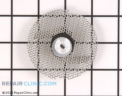

If the heating element ohm tests good, The only other possibly could be the pump motor assembly not circulating the water properly, thus making it do the 7 clean light flashes.
Check your chopper screen, it may be clogged, and your check valve too.
Watch this video first:
[video=youtube_share;iRCCrEwrst8]https://youtu.be/iRCCrEwrst8[/video]
Here's the chopper blade screen assembly for your model:
Food Chopper Assembly WP8268383 Order now for same day shipping. 365 day return policy. RepairClinic.com
Here's the video to check/change it:
[video=youtube_share;lRDbTgBOtIE]https://youtu.be/lRDbTgBOtIE[/video]
Here's the check valve for your model:
Check Valve WP8268375 Order now for same day shipping. 365 day return policy. RepairClinic.com

thanks jake! i'll run the sequence first. when i first started on this project, i also cleaned out the drain. chopper, etc., so that step is taken care of. so basically, there are only five possible causes at this time:
1. bad control panel...fixed.
2. bad touchpad...fixed.
3. clogged drain/chopper...clean.
4. bad heating element...on the list to check with ohm meter
5. diagnostic service cycle never implemented correctly...will do now with fingers crossed.
