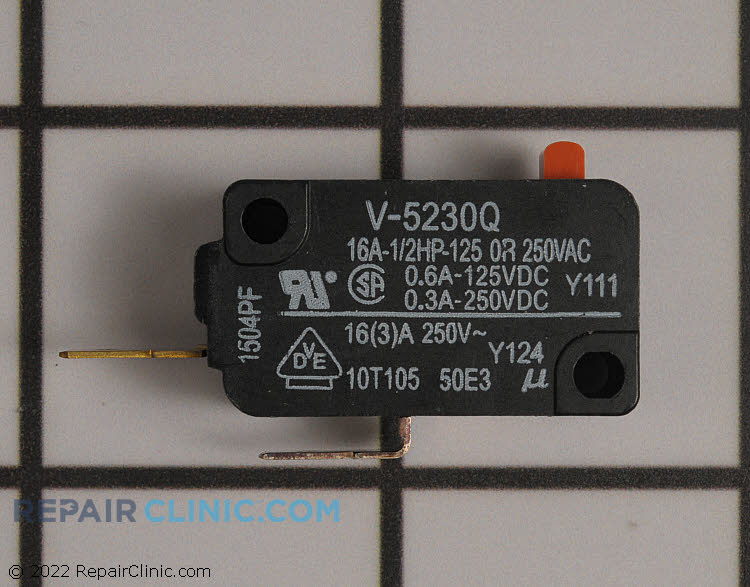

The bottom door switch on our 2007 microwave keeps going out. I’ve had to replace it twice in the last 6 months. Anything else to check to stop burning them up?

What switch are you putting in? The original ones says that the switch is NLA.
This one looks like a suitable replacement:
LINK> Microwave door switch, normally open two terminals
If there are any pitting or discolouration on the wire terminals, replace them at the same time.

I replaced it with one from a local appliance parts dealer. I’ll have to pull it out and see.
What is NLA?
The other switches looked fine the first time but I did replace all of them to make sure. I’ll find out tomorrow when I pull the oven out to see which one, but last time it was the bottom one which is a normally closed one.

Thanks. Finding and replacing the switch is fairly straight forward, I’m just trying to figure out why it keeps failing. This will be the third switch in 6 months.

Show us ( pics are great ) the switch you are using. How has the switch failed 3 times?

The first pics are the failed switch. It’s the bottom one of the three. The one with the orange button is the new one. The failed one looks melted next to one of the terminals and it’s bent. The red button also does not spring back up.
Last time it failed the button still sprang up, but there was no continuity.
Edit: I see I have the wrong one to replace the bottom one…going to get the correct one.

Says 16 amps on the grey switch which should be ok.....but I have found them to be a lower quality than the black body versions....JMO!
Definitely getting too hot and melting the body plastic. Make sure the spade connectors are tight on the switch terminals.
