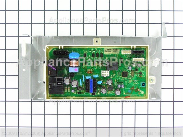

I am still trouble shooting this Samsung Dryer DV42H5200EW/A3 dryer! I think it may be the relay, but had another question about testing it. I have the dryer completely dissembled, so no power to use when testing. I test across one leg of the incoming power cable to ground I get 10-14 ohm and from the brown wire to ground at the relay the same, but when I unplug the relay there is no reading ---open circuit (also tested relay leg to leg and there is nothing) . where is the resistance coming from? I tested everything and can not find it, but I am just an amateur and probably did something wrong. I have the motor unplugged/connector removed.
Thank you for your time and advice.
139,337
The resistance is coming from the cord itself, which is normal.
It sounds like the control board went bad on you, do you see any burnt spots on it?
Put the dryer back together and plug it in, just leave access to your control board, then Locate the CN1 connector on the board and put one meter lead on CN1-Pin 1 (BRN) and leave it there. Touch the other meter lead to the black wires on top of the RY1 and RY6 relays. At least one of the wires on each relay should have 120 Volts AC. Disconnect then reconnect all the connectors on the board.
Main Power Control Board DC92-00669Y
