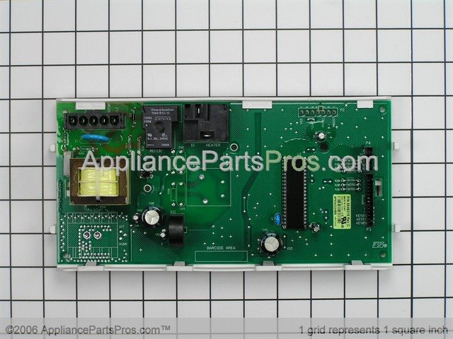

Dryer heating but temp controls only work on high or medium. Low, extra low and air only controls stay at medium. Air only is heating (I can see the heating element is on.) Tested thermistor at room temp and 100 F and resistance is within spec. Already tested heating element, thermostat and thermal cutoff. All OK. I'm thinking the heater relay on control electronics board may be faulty. Does this make sense?
137,363
Hi, If your absolutely sure your heating element is not shorted to your heater housing ground, then yes, it could be a stuck relay on the control board, thus that's why it would heat on AIR DRY.
Unplug your dryer then look on the control board and you will see a black relay marked HEATER, Ohm the 2 terminals on that and see if you get continuity.
WP8546219 Control Board

The resistance on heater relay showed OL on the Ohm setting and no sound on the continuity setting. is this correct?
That's good, it should not show continuity with the dryer off and power disconnected to the dryer.
What is odd is you should NOT be getting any heat at all in AIR DRY/NO HEAT cycle.

could I have damaged the circuit board while testing the thermal relay and the P2-5 to P2-6
Anything is possible however if the testing was done with power disconnected, it is unlikely. It is possible just a wire has become disconnected to that circuit and is now responsible.

Tried new thermistor but still E1 on heat cycle. Anything else I should test while waiting for control board.
Dan O.
Appliance Tech
Oct 9, 2004
6,590
The only other thing I can think of is the wiring in between. Maybe it got damaged somehow and the control isn't able to detect the sensor? See if you get the same readings at the sensor and at the wires where it connects to the control.
