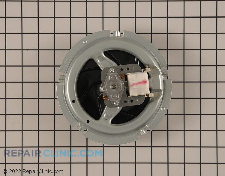

Hello all, Electrolux range fan started making this grinding type noise when cooling after using the oven. Noise is coming from under the cooktop and not the convection fan. Here is a video with sound. Can someone confirm the part required and is it very difficult to change?
139,337
Yes, bad cooling fan motor. When you click the part link to the cooling fan motor below, you will see a video of how to replace it.
Cooling Fan 318575600
