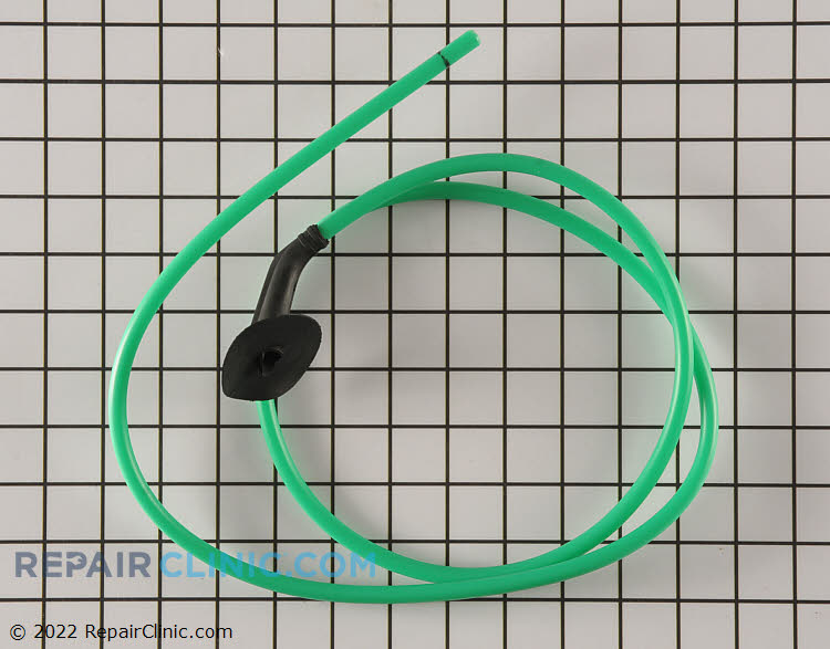

So, as a last desperate response to a failing ice maker due to the fill tube freezing over, I purchased and replaced the fill tube. During the replacement, I also noticed that the small insulation/foam piece on top of the ice maker box, was not properly surrounding the hole for the fill tube. I was able to tape the insulation/foam in place. Also, the new fill tube had a layer of insulation around the part of the tube closest to the tray that was not on the old part. Finally, we have a functioning ice maker again.
At some point in the future, I would like to replace the insulation/foam piece that surrounds the fill tube hole on top of the fill tube hole. Can this part be purchased? If not, can I buy something at the local hardware store and just replicate it?
thank you.
137,719
Excellent, glad you found the problem.(y)
Here's the fill tube for your model in case others need it as well:
Fill Tube 241920106
