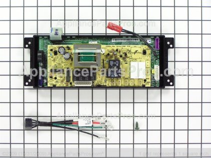

Hi, When preheating the oven it won't get to temperature. Say I set it for 350 it might get up to 200 over an hour. I can feel the top element is hot. I tried opening up the back panel and pressing a reset switch back there, but the problem remains. I can hear the convection fan running and see it spinning, top element is hot and it sounds like the oven is clicking periodically which I don't recall it doing before while trying to get to temp. Recommendations?

Sounds like either the clock oven control board isn't sending the proper voltage to the bake element which should be 240 volts, or the bake element itself is starting to go out.
You'd need a multimeter to ohm test the bake element.
Did you check for 240 volts across the bake element terminals when set to BAKE 350?
Here's the clock oven control board for your model:
5304495521 Kit

I am not sure if this is the correct way to test the control board but I found the two spots labeled bake and broil on the board. While holding the black lead on the multimeter to metal and inserting the red lead into each of those connects they both read ~122V.
With the oven set on bake at 350--->Measure the voltage between P9 (BAKE) wire and P1 (L2-OUT). Meter should indicate 240 VAC. Make you don't anything else when volt testing, and also when your done volt testing, disconnect power to the range.

Thanks Jake for the reply. I tested voltage across those two terminals and wasn't getting any voltage across the two. I am guessing that means I am going to need a new control board. Looking at the prices and the fact that the range is almost 10 years old I think we are going to replace it since we could also really use a double oven now that our family grown. Appreciate the help and sent a donation. You all also helped me fix my washer last time it broke and part I ordered is still going strong. Thanks again!
