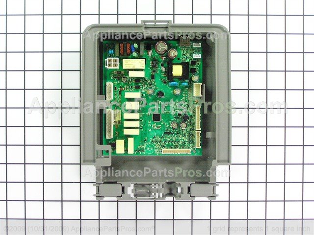

The dispenser module or main power board is possibly the culprit.
I'm attaching your schematic below. In SYSTEM DIAGNOSTIC MODE you can activate test 10--->Auger Motor to see if the Auger Motor runs for longer than 2 seconds.
If you want to volt test--->The main power board is located under the front of your refrigerator. Unplug the refrigerator first before removing it. Then plug it back in before testing it.
Then take a volt reading at these on the main power board, make sure the doors are closed.
RL6-->J2-2
RL3-->J3-1
The PURPLE wire and LT BLUE wire goes to the auger motor, see if you get 120 volts with the ice dispenser paddle pushed in and keep holding it in for more than 2 seconds to see if the voltage stays at 120 volts.
Here's the main power board for your model:
Board-Main Power 5304502778
Here's the dispenser module for your model:
242270102 Module
