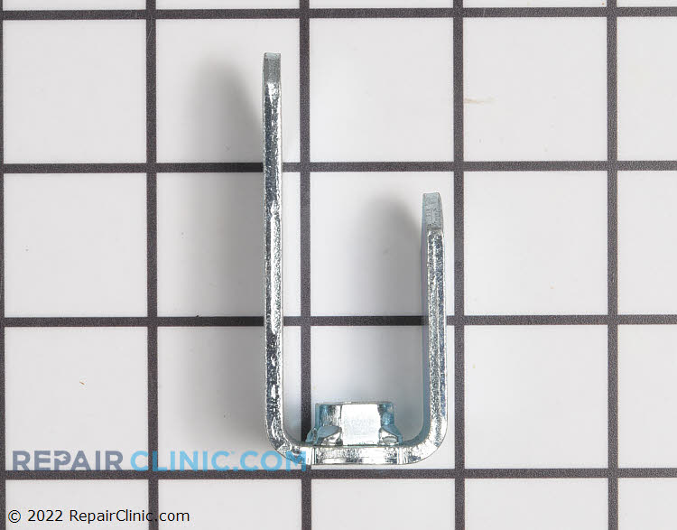

I have a Frigidaire FGSC2335TF0 and the ice won't dispense. The ice maker works, the auger spins when engaged, the crushed ice gears spin and both the ice box door and ice dispenser doors open when on crushed or regular ice but the ice won't actually push through. I'm at a complete loss.

Here's the auger drive bar for your model:
Auger Drive 241829001

And what does item #45 do in the diagram you shared? is that the switch for cube and crushed? i noticed that is loose and can move to the back of the freezer but still engages when pulled forward.
Here's the parts diagram: Parts for Frigidaire FGSC2335TF0: Container Parts
#45 is the Solenoid and Yoke assembly that makes it switch from crushed ice to cubed ice.

My initial thought is that the Solenoid and Yoke assembly may be the culprit since it's moving around.
That being said I will need to pull it out to very as something tells me that maybe the ice box assembly that holds that yoke and solenoid in broke so it's not the part itself but the housing or mold around it that holds it in place.
