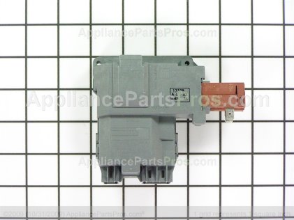

Door latch was my problem
I recently had this issue with my FWT647GHS1 Frigidaire Gallery front-loading washer and it turned out to be the door latch.
The first time it happened years ago I called out a tech only to find out it was because I didn't have a heavy enough load in the washer.
This time I checked this forum first and found a number of suggestions, many of which suggested using a voltage meter to check various pins that connect to the speed control unit. I went to my local Harbor Freight and picked up two multimeters for $4 each!
If you are interested in doing this kind of testing, open the bottom panel of the washer and pull out the tech sheet you should find in a manila envelope taped to the inside. On that sheet is a pretty good list of step by step instructions to check these connections.
My lack of confidence was my undoing. I wasn't getting a 120V reading when I was supposed to, but I thought I wasn't doing something right, so I figured that the timer was the problem. $108 later I found out I was wrong.
Next I figured the problem was the speed control unit. I should have known better, because if the voltage wasn't getting to the speed control unit then it shouldn't have been my next step. $106 later I found out the speed control unit wasn't the problem.
The only other possibility, it seemed, was the door latch. Turns out that was it. After having been to the parts store twice already that day they cut me an awesome break on the price, but since I couldn't return the other two parts I was still out more than $200.
I learned a lot, and believe it or not I enjoyed the whole process, but I wish I had taken the advice of the first poster in this thread -- the door latch was the cheapest of the parts and would have fixed it on the first try.

OK, after diagnostic test, error code 43.
E43 Board communications problem. Replace the control board.
Is that easy enough for someone who is NOT a mr. fix-it to do?
Plus, what's the difference between the control board and the speed control board? Tha manual is very descriptive on how to replace the speed control board, but not so the control board.
107,811
Ok, I did some research on the E43 and a few other members replaced the control board and that didn't fix it.
It turned out to be the door latch/lock assembly that was the cause.
Here's the door lock assembly for your model you can order here:
131763256 Door lock and switch assembly
Start reading at page 67 in the repair manual to remove the door lock assembly(Safety switch).
To test the door lock switch:
Remove the door lock assembly and
measure the resistance of the PTC.
The PTC is the wax motor on the door lock assembly. You will need an ohm meter to test that.
If it reads 1500 ohms, then its fine.

Yes I know, but I'd rather have you check for 1500 ohms at the door latch to make sure thats the issue or not.
bruckm
Apr 17, 2011
7
Texas
wax motor, if it is the same part as on page 49 of the manual, measures 14.00 kΩ (approx as it never settled on a specific number) on the meter that I borrowed.
14.00 kΩ is what the meter read.
107,811
Then its your door lock assembly thats bad, it should be 1500 ohms exactly.:)
bruckm
Apr 17, 2011
7
Texas
Ok, so just to make sure here. Even though the door does lock properly, that's the part that's not working. When it is washing, the door IS locked and I cannot open it. When I run it through the diagnostic testing, the door IS locked and I cannot open it...except on the one setting where it tells you you CAN open it but don't do it.
You're saying that for whatever reason (lack of ohms resistance), the system thinks the door is not locked and therefore it isn't allowing the washer to complete its cycle, even though the door DOES actually lock.
107,811
Exactly.
