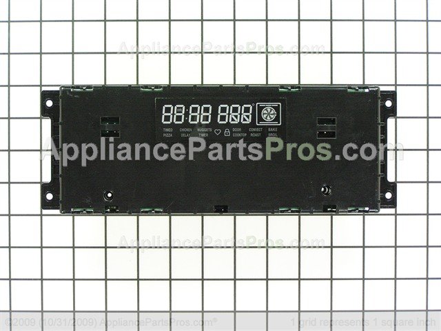

137,470
Then the only part left that controls the oven temp is the controller.
Controller 316560151
Also look at what fixed it for @Bunky
dallaspaul
Apr 27, 2022
Texas
Thanks. I've already replaced the control board, so the next step is to find that breaker.

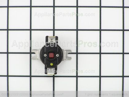

137,470
Yes, but I don't see a breaker in the parts list. I do see a thermal switch with a button on it you press to reset it.
Make sure you turn the breaker OFF first to your wall oven before accessing it and ohm testing it, also take both wires off of it first before ohm testing it.
It's located either on the top of the oven OR behind the back access panel in the very back.
You will likely need a helper to pull the wall oven out from the wall, it's very heavy.
Here's the thermal fuse for your model you can order if needed:
Thermal Fuse 318004900
You will need a multimeter
Watch this video to ohm test it: Thermal Fuse Ohm Test Video
dallaspaul
Apr 27, 2022
Texas
I located and removed the thermal switch. I pushed the red button but it did not move, so I assumed it was in the correct position. I tested with a digital multimeter following the steps outlined in the video and got a positive result for continuity. I reinstalled the thermal switch, placing 1/4" plumbing washers between the body of the oven and the screw tabs on the thermal switch (per @Bunky).
I started the oven and got the same result--it is not fixed. Next step is to replace the thermal switch completely and see if that works. Beyond that I am out of solutions, having already replaced the temperature sensor and the control panel.
137,470
If the thermal switch ohms good, then there is no need to replace it, because its good.
This is a very uncommon problem, you may want to have Frigidaire come out at 1-800-374-4432 to see what's going on.
