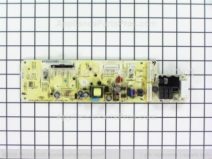

My Frigidaire gallery FGID2466QF2A from 2014 refuses to start. The front led work fine. The start button works, but when I close the door, nothing happens.
The door latch tested good for continuity.
When I power cycle, PF appears, and I can hear the circulation pump quickly spin for 1 second if the door is closed. If the door is open, I do not hear the pump.
I took apart the circulation pump to clean out the debris.
When in PF mode, I enter service mode, the led says CL, regardless if the door is open or shut.
Anyone have any clue?
CL means--->Close and latch the door.
So if your door latch switch ohms good, then it has to be a bad control board not seeing the door is closed and latched.
Here's the control board for your model you can order:
5304504782 Board
Dumb question, but is there any way to trick the board to think it is latched?
I took apart the board. When I shake it, it seems that the white TE relay is rattling. Has anyone had success replacing that relay?
That I don't know.
Hopefully someone can answer that, as techs. we are only allowed to replace the control board per the manufacturer.
A new board did the trick.
However, I installed a 530450782. Is it fully compatible? As far as I can tell it works.
5304504782 is the correct board I posted in post #2 for your model, yes it is compatible.(y)
