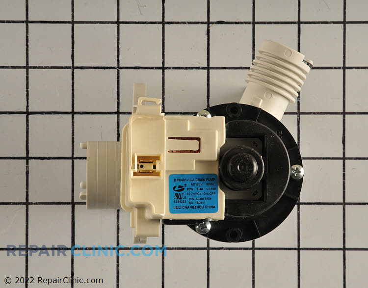

FIXED Frigidaire FFLE3911QW: Washer stopped working in the middle of load and does not drain
liviekins
Feb 23, 2021
Toronto, ON
FFLE3911QW
Frigidaire
I was washing a load of clothes and noticed that it was running a lot longer than usual. Upon investigation, I found that the machine was making a buzzing sound. I turned it off and opened the washer to find my clothes were still soaked. I tried to re-run another cycle and this time it filled and did nothing else while still making the buzzing sound. It also started emitting somewhat of a burning smell. I am including a recording of the buzzing sound here.
I've tried to do some troubleshooting and I'm thinking it could be the drain pump? Please let me know if you have any insight on the issue on how I can go about fixing this issue! Thank you!
135,806
That link does not work, its says 403 FORBIDDEN.
Yes, I'd first check the drain pump for something stuck/jammed in it.
Here's the drain pump for your model(Video Included):
Drain Pump 5304524452
135,806
Ok, That file works, what cycle was the washer in when it made that noise? The drain cycle?
135,806
Rinse and Spin would also Include the Drain Cycle, so yes check for a foreign object in the drain pump making that noise.
liviekins
Feb 23, 2021
Toronto, ON
Thank you for all your guidance on this problem, Jake. I found a sock had somehow gotten into the drain pump causing it to jam. As a newbie, I underestimated the amount of water that would leak out when removing the pump and accidentally caused a tiny bit of water damage to the hardwood adjacent to the tiling. That's a fix for another time, but for whoever reads this - don't be like me!
135,806
I found a sock had somehow gotten into the drain pump causing it to jam.
Excellent, glad that was all it was.(y)
